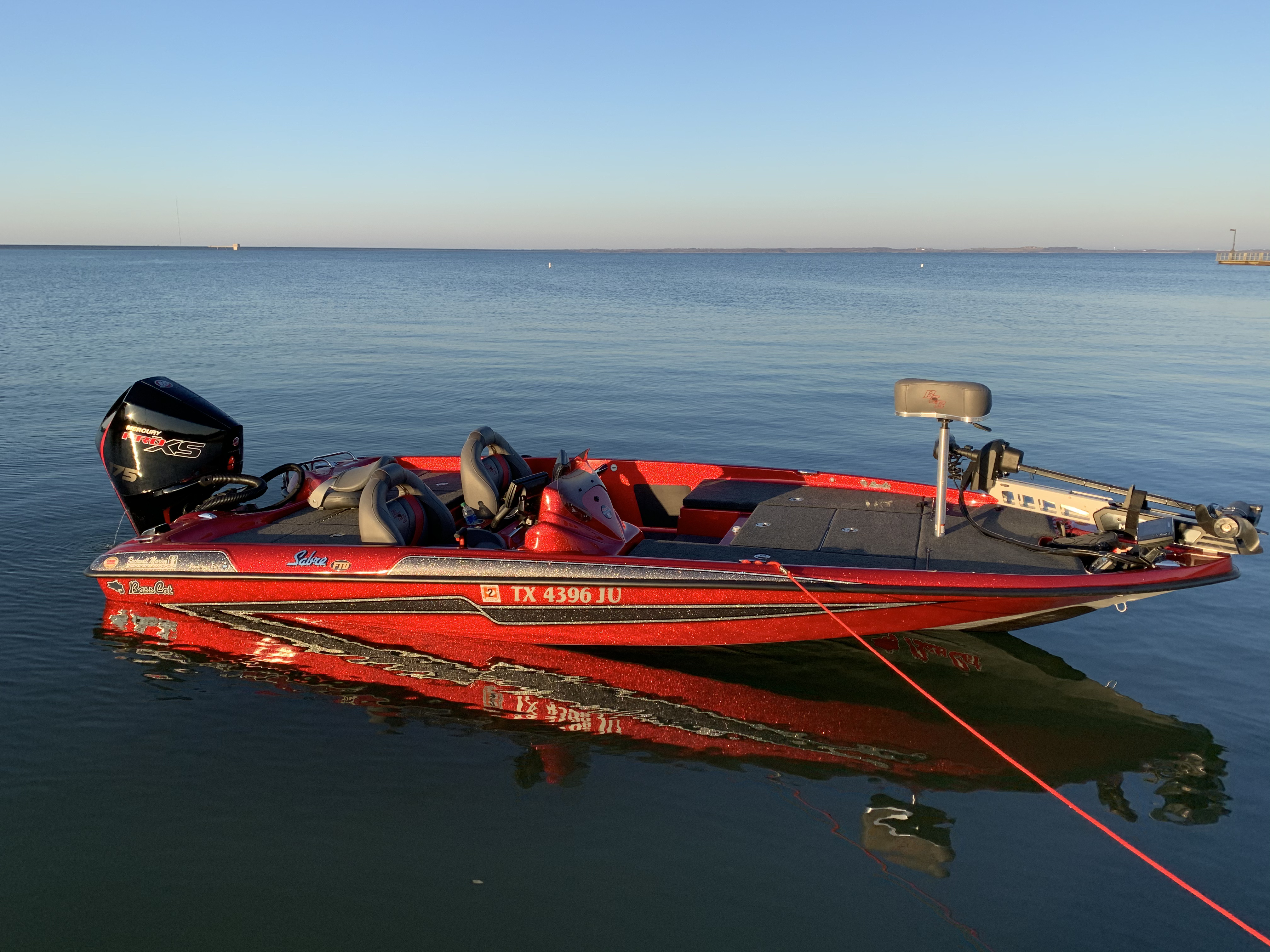

Well let me give you the break down, but I did find that adding my 100 pound son to the cooler this past week dropped the speed down 20 mph. So yes nose heavy affects the performance a lot.
When I purchased the boat and it was empty expect for me and 1/4 tank of gas I was only able to touch 66 with very heavy steering. Meaning it was hell to bump the steering wheel to control the chine. Then loaded as with tackle(i don’t change anything) full tank and my oldest son. Together we are about 300. Plus I had a 25lb anchor(gone now). Still only able to get about 66 if lucky touch 67.
Then I raised the motor and then fully weighted down I can easily get 67-68 and chine is much easier to control with both of us in the boat full tank, anchor and I had about 60lb tool box(been trimmed down to the import stuff now) next to the batteries. Currently the boat drives the best at WOT. On calm water to light chop it is very good now. Much like this boat(it is a 2 stroke) BassCat Sabre FTD 175 Mercury – YouTube
I don’t think he is loaded, but I carry all my tackle in the first box, some other tackle in the front with rain gear. The performance out of this boat really has NOT changed other than increased some speed and control. This is why I was trying to understand what motor height does to a boat in both extremes, too low and too high.
It was my Sabre Wheelman drove. Have a 4 blade on it now. With tackle in the rear, the boat runs 68-69. Thats with an Ultrex on the bow. The boat does not like a ton of weight in the bow. Heavy stuff in the back. Light stuff in the bow and it will run.
Correct I am running 68-69 now with all my tackle up front and yes a few of the box combined is some pretty good weight. But real heavy stuff is in the back. The boat is running faster weighed down.
At the end of the day my understanding still has not been answered. Why does the boat run better and a bit easier to stabilize now that the motor has come up? I have heard from other with 150’s but there seems to be some big differences in the two motors. Is that why moving my up helped? I perfer the boat to run the way it is, now I not sure how much 3/4 to an inch hurts in ruff water but that so far is just slowing down.

Thanks again Rich, beautiful boat you have!
