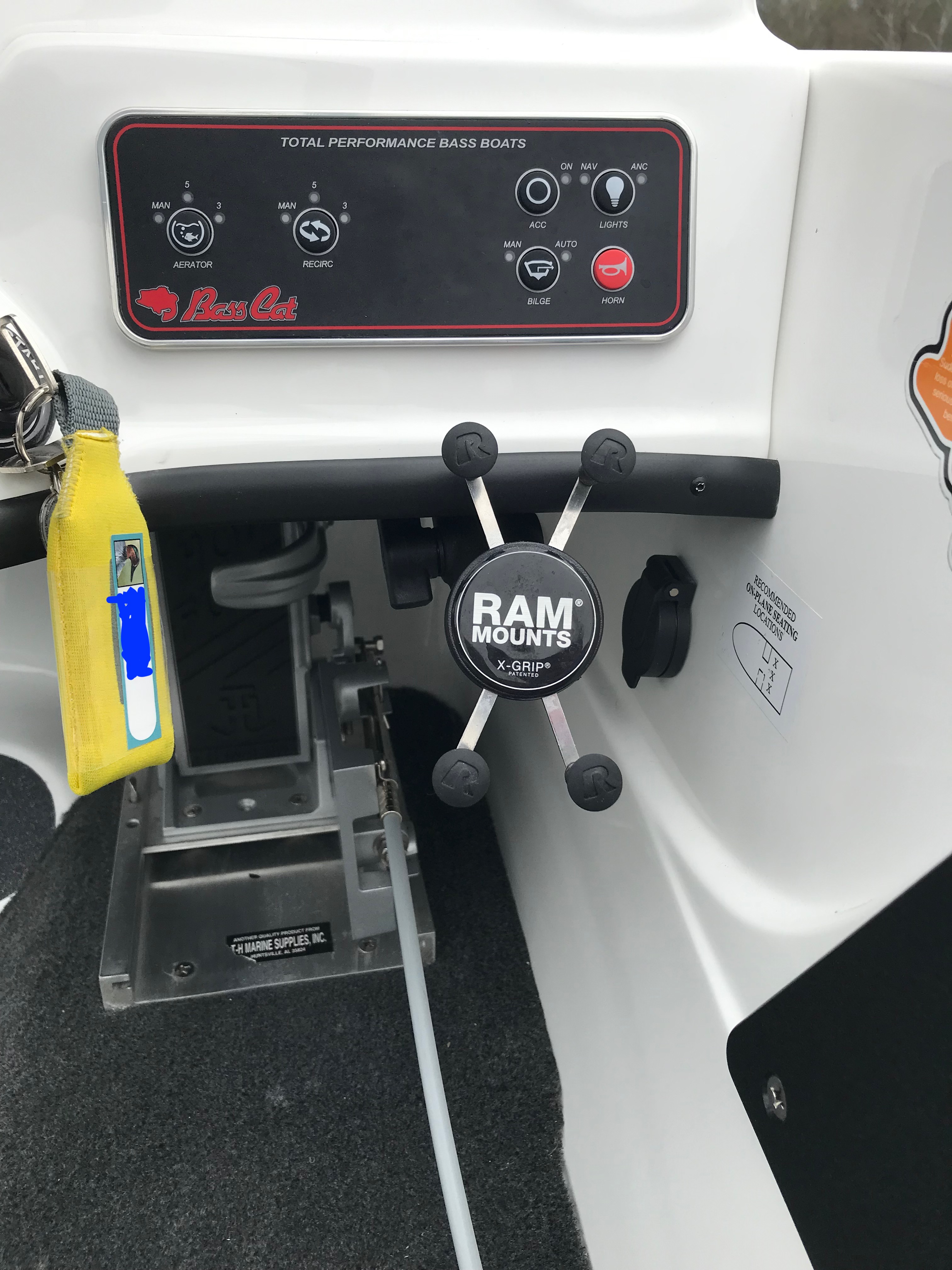

You likely know that the master power switch/breaker in the battery compartment needs to be on for any of the accessories wired through the boat’s harness to be able to function, including the auto bilge that is already there. I wired in compartment lights and tapped power from the USB port. I then supplied my own on/off switch for them under the dash. But again, the master power in the battery compartment still has to be on for them to function. You could do the same kind of thing with a bilge pump. I think that the only way to install another bilge and not have to have the master power on would be to wire it directly to the battery, and, use your own on/off switch. Not hard to do.
