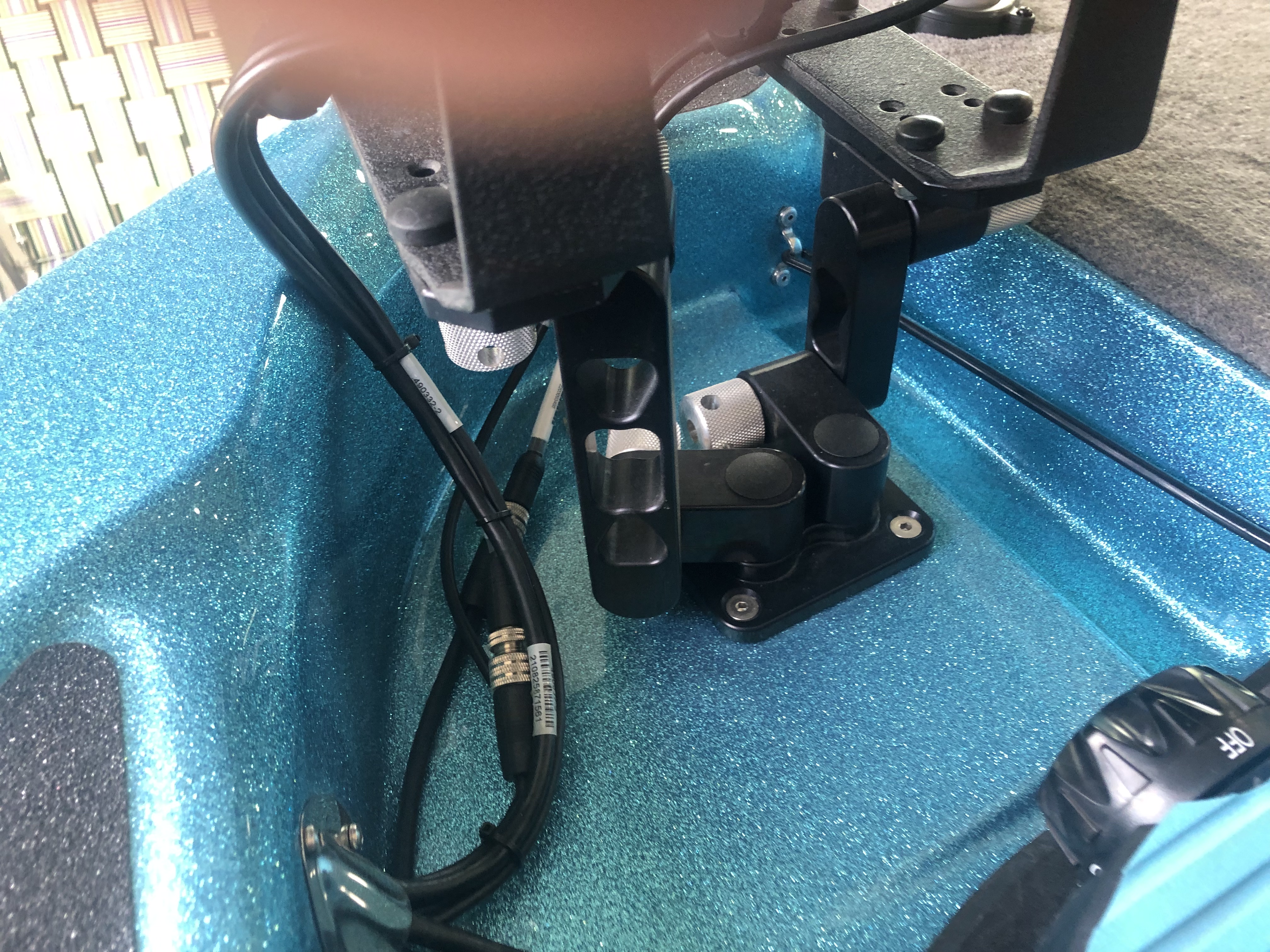

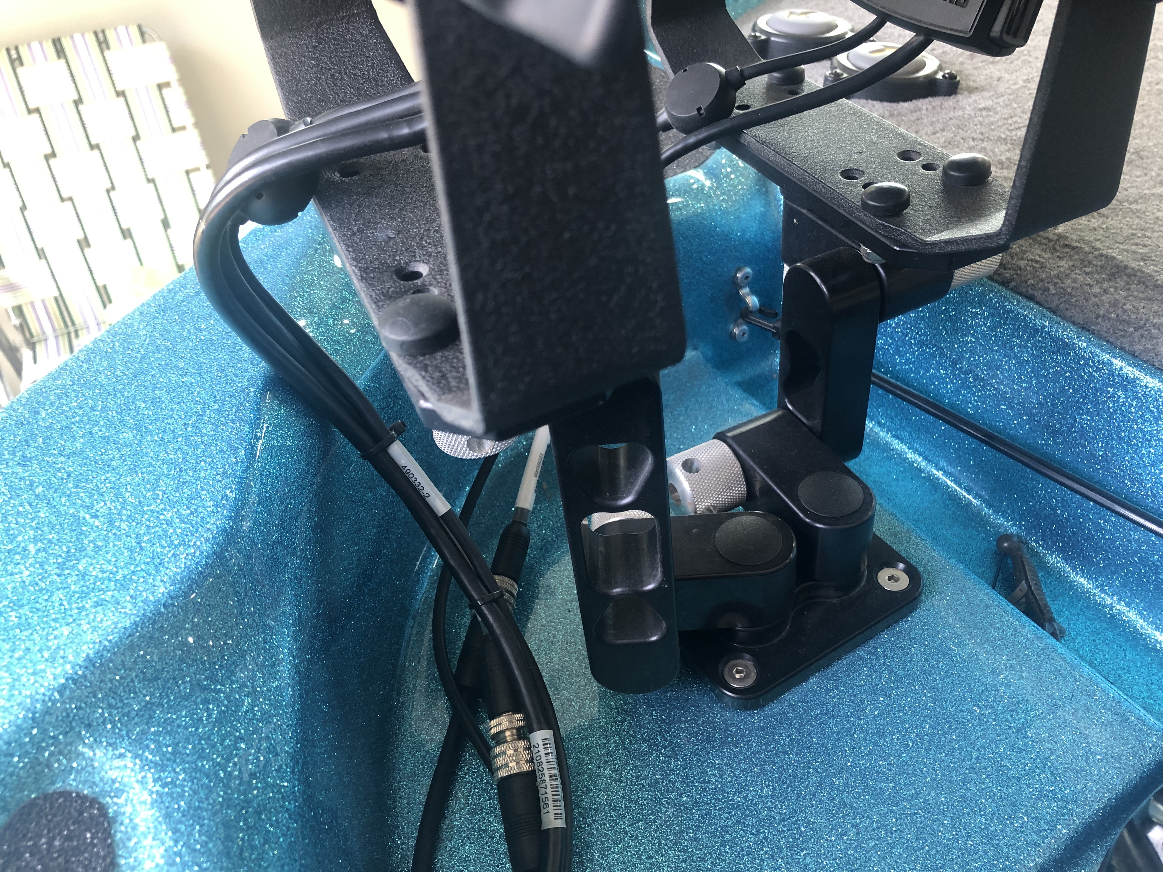

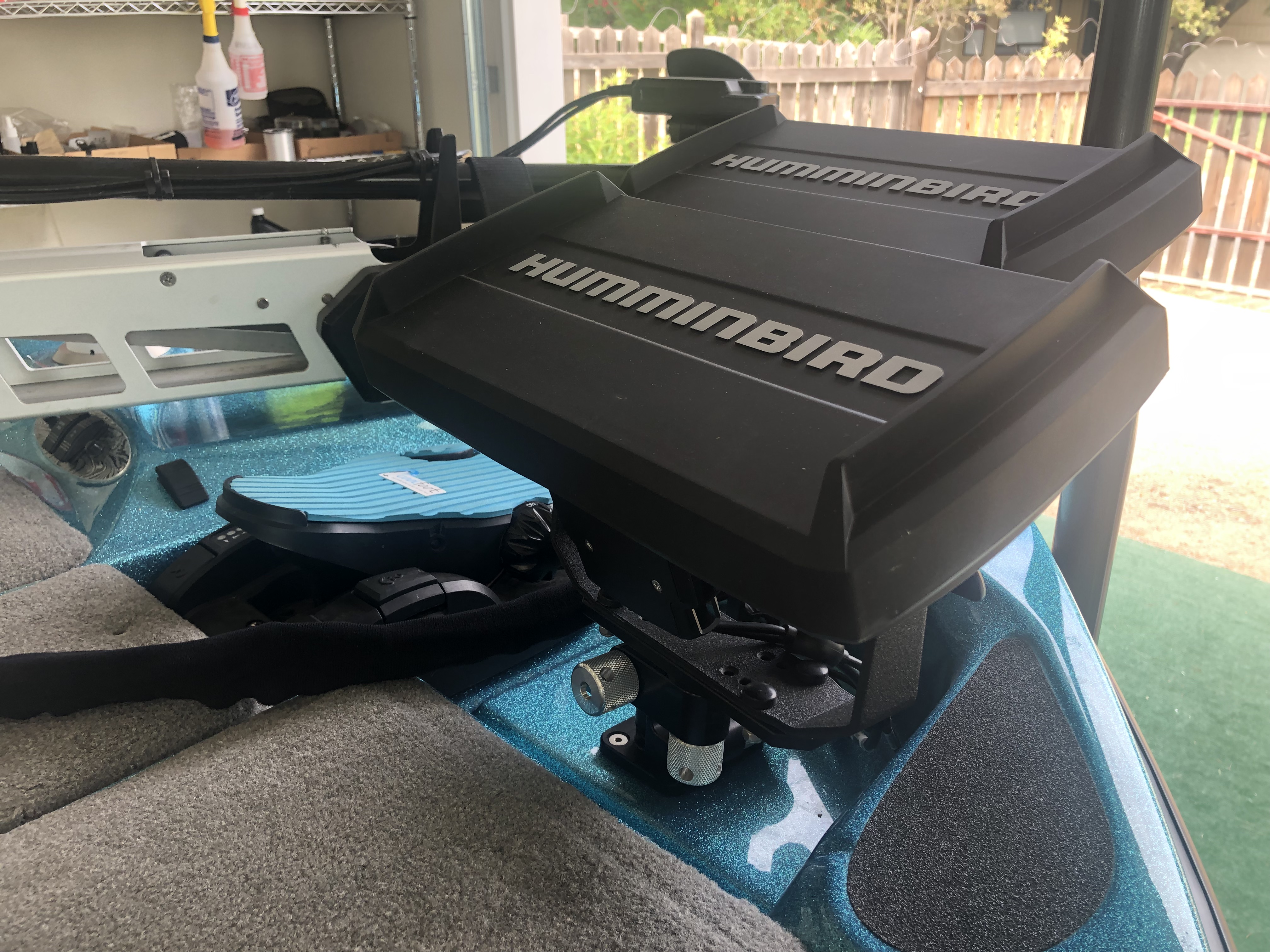

I own a 2022 Caracal which came with a 9″ Humminbird Helix on the bow mounted to a 3 hole Ram mount.
Earlier this year I installed a Balzout dual mount for the 9″ and a 10″ Helix and I love it!
I was able to use one of the 3 holes from the Ram mount and installed a 5″ x 8″ x 1″ plastic backing underneath the fiberglass tray.
I bolted the Balzout mount through the tray and backing to strengthen the area since this was a heavier mount with an additional graph.
So far it’s working great!
