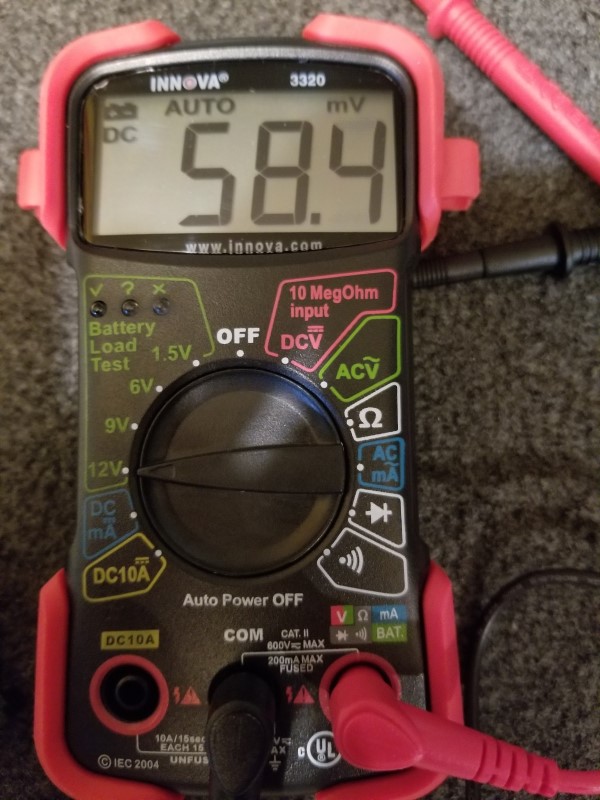

I bought a voltmeter, but am not positive I’m using it correctly – I have it set on 12V.
Charging (flashing) – 13.81
Not Charging – 13.47
Car battery – 12.8
How do my numbers and multimeter setting look? If ok, I was considering trying to test for parasitic draw next via the terminal block.
Mrbraq, to measure DC voltage use the switch position that says ” 10megohm input DCV”. (red color). I would think you need to put switch into the “DC ma” position. (blue color) for parasitic draw check because you are looking for a small current reading in milliamps. Careful here because you will have to remove wires for this check so you may want to get some help from someone who is more familiar with that.
The position of the switch as shown is not the right position for what you are looking for. Take your readings again using the other DCV position that I mentioned first.
