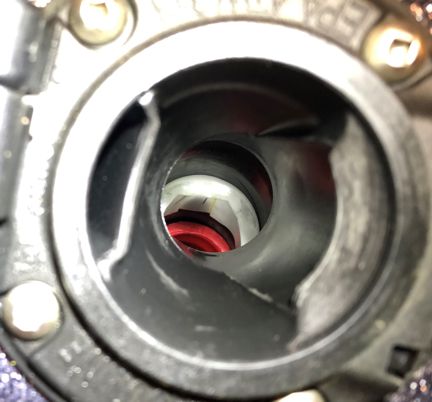

I have a 2016 Puma FTD.  Since day 1, the port side tank filled normally, but the starboard tank has taken about a half hour to fill.  I absolutely dreaded filling it and have avoided it as much as possible.  So, I constantly fill the port side tank and only fill the starboard tank on those very rare occasions when I know we need both tanks during a trip. I want to solve this problem.  I’ve read the “Trouble Filling Gas Tank” post in the FAQ Archive and, as suggested, used an LED light to look down both the port and starboard fills.  It was immediately apparent that the starboard side flapper was not in the right position (instead of sitting on top of the white piece, it is below the white piece, laying loose, on top of and blocking the red tube).  Here is a picture of it:   I used a pronged parts grabber and was able to pull the flapper out. Do you think this will solve the fueling issue? Have I created a safety hazard by doing so? Is repair a fairly simple process or should I take it to my dealer (or the factory)?
