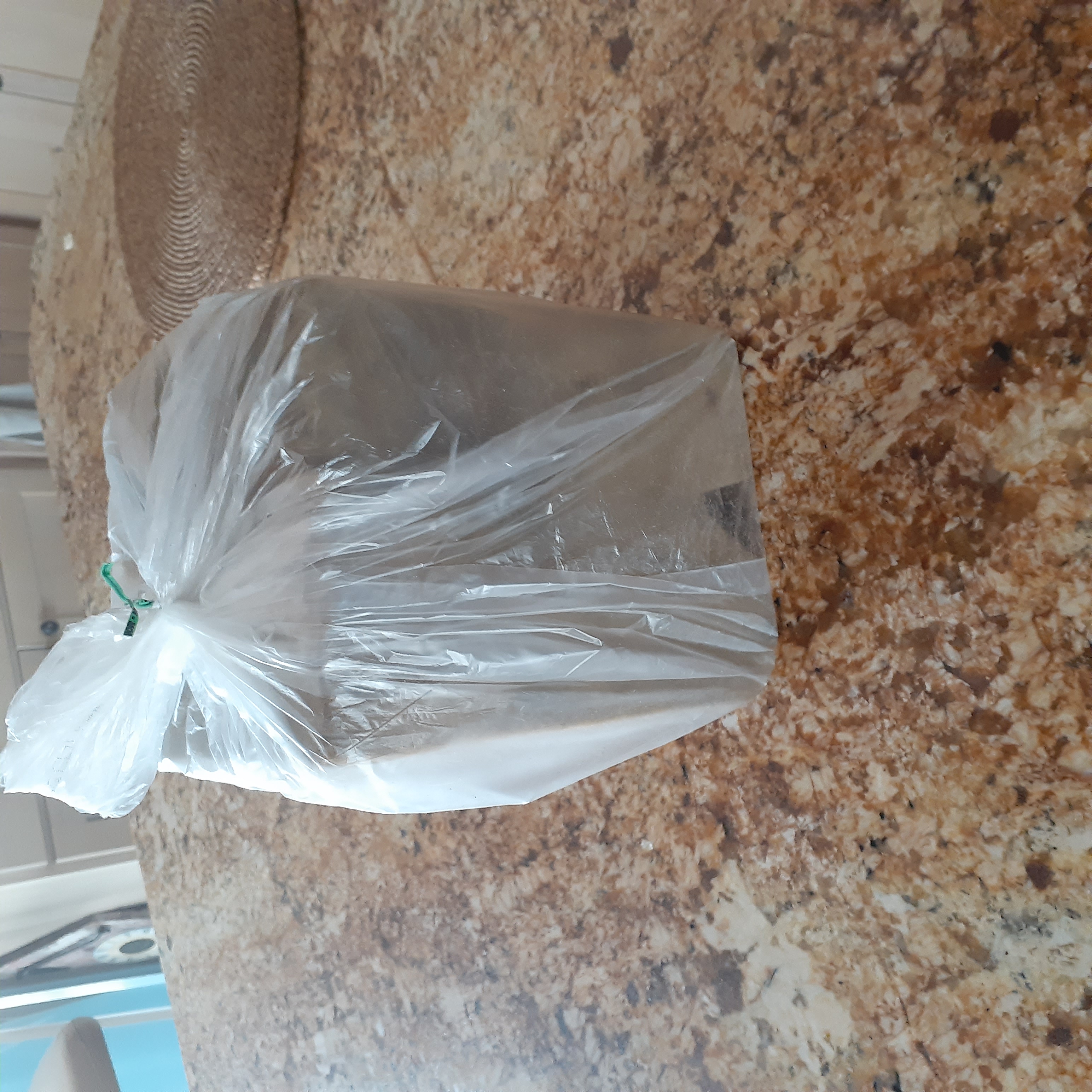

My only other water issue was the piece of furniture foam in the flimsy plastic bag twist tied closed under the floor. It shifted backwards and blocked water from draining out of the floor to the bilge. It is a really bad design that I feel was a cobble fix and I certainly hope it has been updated by now. If not a check valve flap at a wall would fix it.

I wanted to show this engineering excellence in design. This is the piece of open cell furniture foam that shifted behind my floor drain that kept water from flowing to the bilge and flooded the floor in the rain. I found it by removing the drain cover and sticking my hand to the rear of the boat. When I pulled it out, it was saturated with water in a cheap plastic garbage bag with holes in it and a rusty twist tie. I put it in a bag just like what I found it in to show you what is down there. I removed it and never did something more. I rarely fish bad weather don’t spear waves and keep my auto bilge pump on when I use the boat. Unacceptable!!!!
