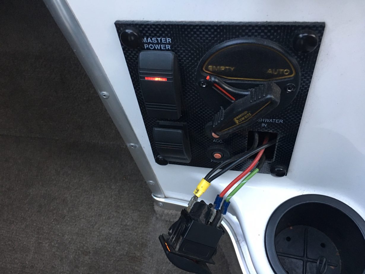

2002 Pantera III. Fresh water in stopped working today. Tested pump, pump is good. Light on rocker switch comes on, so have power at switch. “Pro air” push button breaker near switch not tripped. All other pumps working. Is it possible for the rocker switch to be bad where it’s not sending power to the pump but still light up the red light?
You need to check the voltage in and the voltage out at the switch. The light doesn’t require as much current to shine as the pump does to run.

I’m baffled. Voltage into switch (red wire) good, voltage out of switch (green wire) good. Jumpered pump direct to battery, pump is good. Appears there is an interruption in power between the switch and the pump. Do not observe any damage to wiring. The pumps wire bundle seems pretty secure, just lays in the bilge and is incased in a protective sleeve/wrap.
Just an idea. Did you try running a jumper to the switch from the pump? Sometimes a bad connection will show good voltage but it will not carry enough amperage to turn the pump.
To check if its a switch issue, Swap out the pump in for the pump out switch. They are next to each other and should be identical. If the pump works, than its a switch issue, if it doesn’t, you have eliminated that probability. Remember to make sure wires do not touch each other when removing them from the switches as they will be hot. I would turn off the Master switch until the swap is made.

Jumpered the pump directly to the switch today: pump ground wire to switch ground terminal, pump power wire to switch accessory (green) terminal – pump worked perfectly with switch.
Next jumpered JUST the pump ground wire to the switch ground terminal. Did not jumper the power, reconnected the original pump power wire to the original switch accessory wire – pump worked perfectly with switch.
So… unless I’ve confused myself: switch is good, pump is good, GROUND IS BAD (as many of you have suggested).
