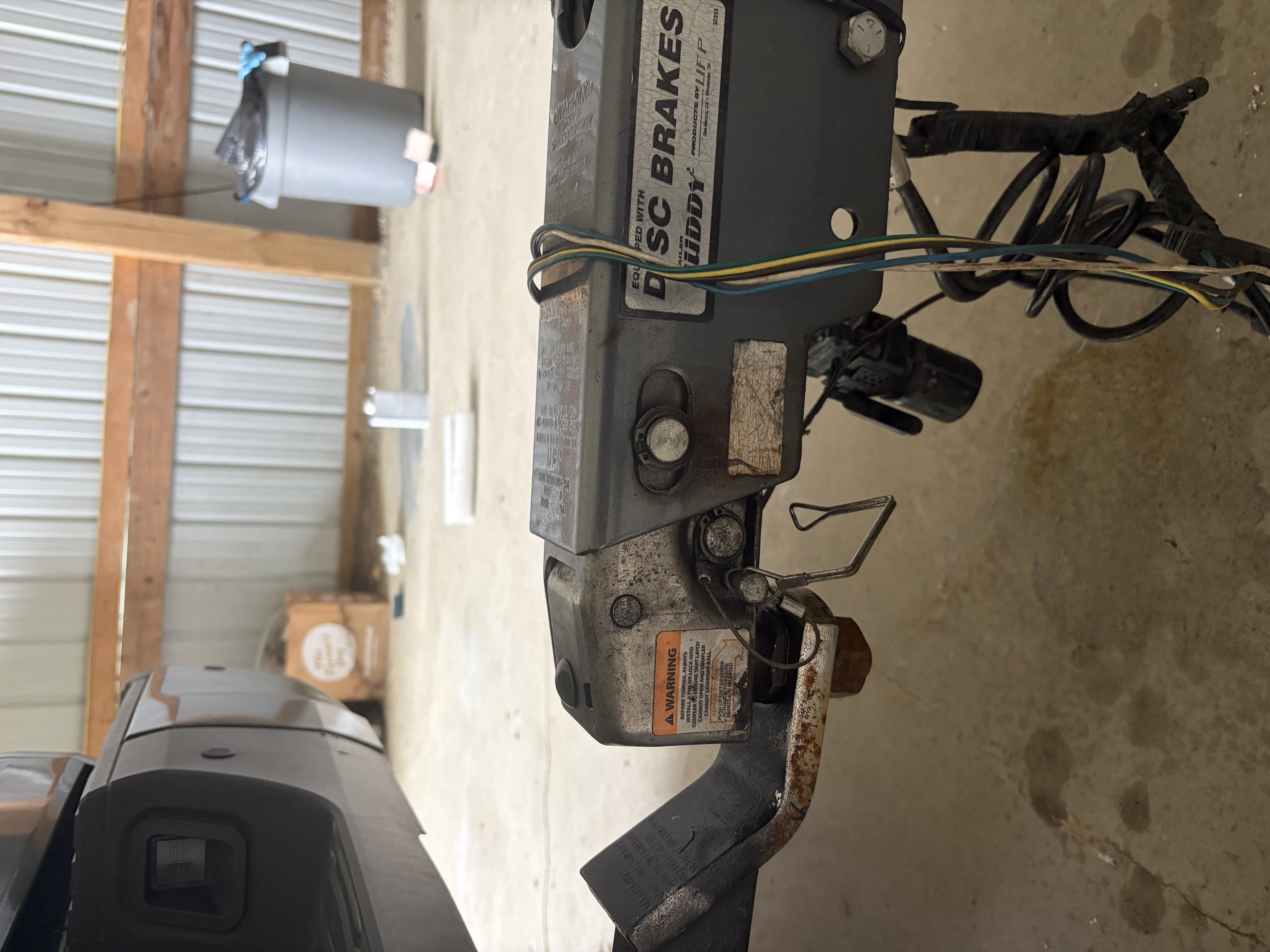

2013 Sabre, recently having a high pitched squeak coming from the actuator area. It’s typically when braking in reverse. Sometimes when initially pulling forward. Any advice?
That’s a A60 actuator and luckily the manufacturer has an owners manual for it. There’s quite a few components to the actuator and brake system. Page 19 has a troubleshooting guide but the whole manual is a great resource. I’m guessing you may have a worn out shock absorber.
