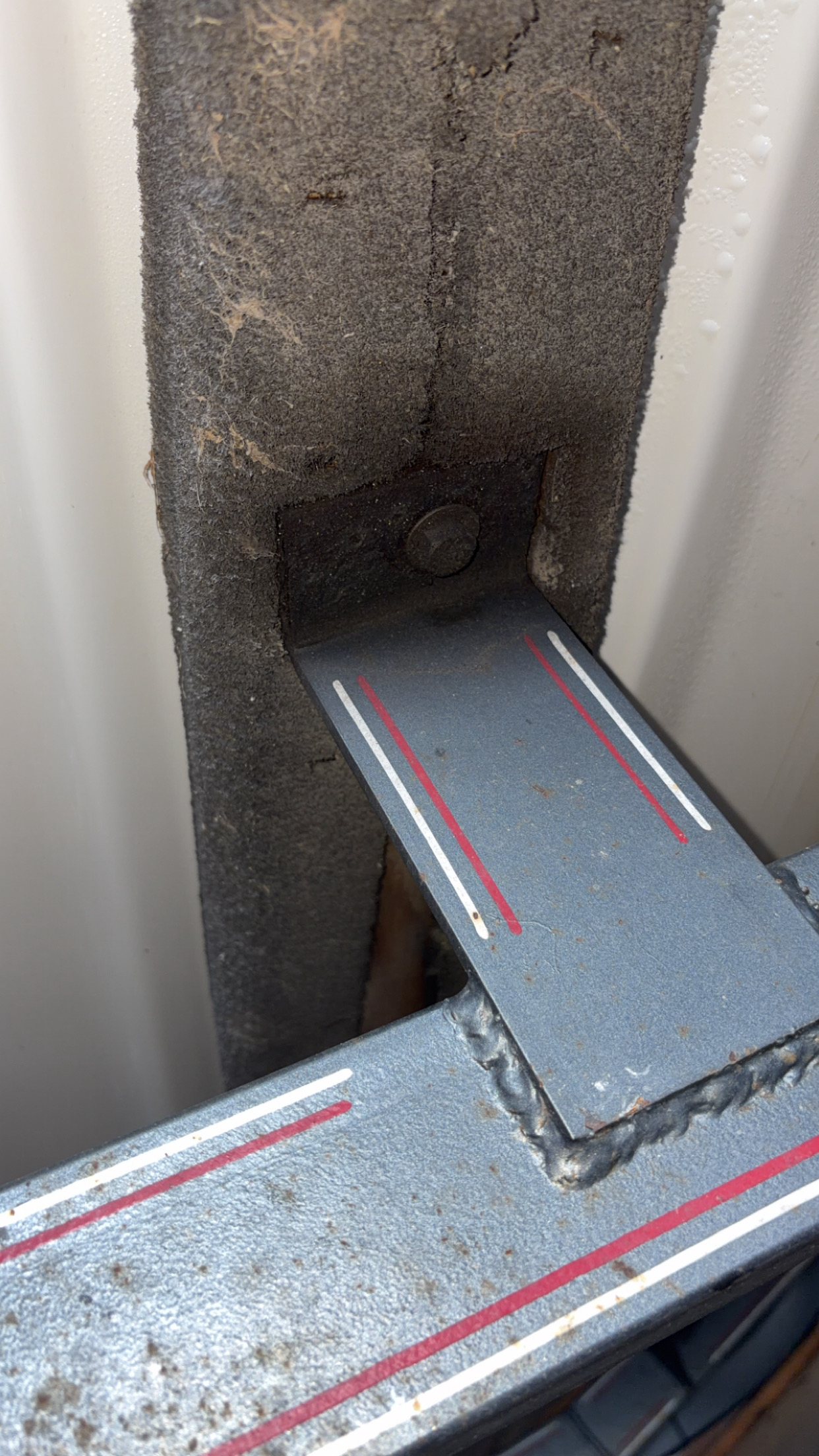

Part of my trailer where the bunks connect to are rusting. How much of an issue does this look like? That part looks welded, how would I go about getting replaced so I can change the bunks?

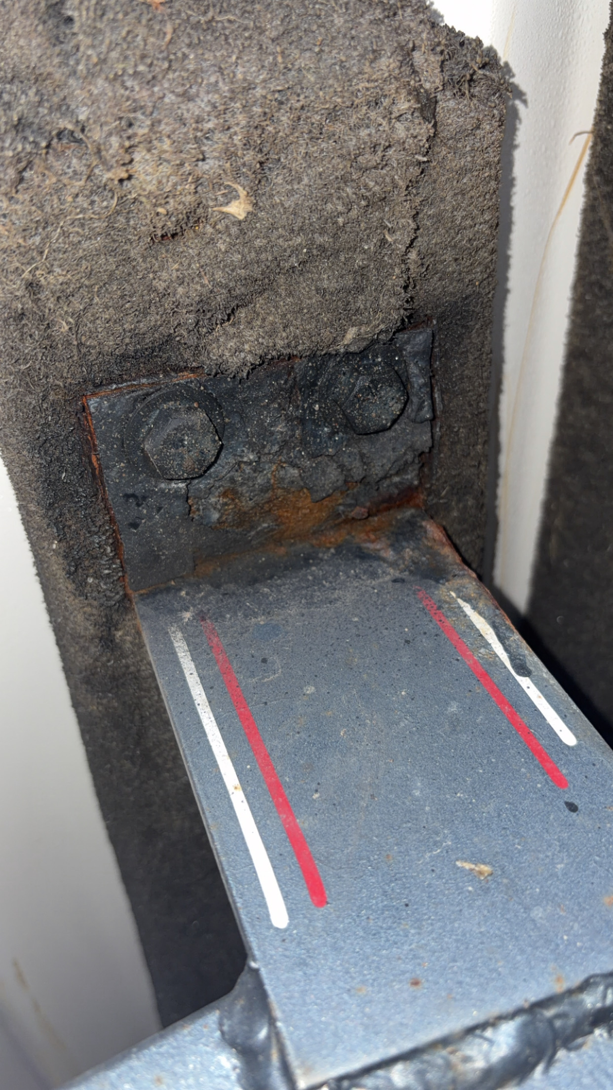

Most of the time that is simply surface rust. Wire brush and a little sanding should remove it. Then you can spray with a rust paint after you have the bunks off.
