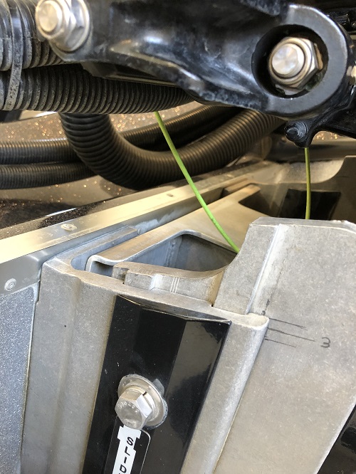

Unravels, here is picture of my jack plate height. It’s a tad over 1/4 ” on this side but exactly 1/4″ on the other side. Each pencil mark is 1/4″ below and above 3″ PTP.

I adjusted the jack plate same as Jim’s, 1/4 inch above flush. Trophy 23 all plugs blocked. Got to take it out yesterday. 2 guys, full tank of gas, loaded, was able to get 69 at a little over 6000 rpms. Tried running the trim a little higher than I usually would, above neutral where pad and lower are even/level, picked up some more RPMs. Never felt unstable, but would feel it lift. Probably could have gone a little faster, will have to save that for another day. Liked how boat ran, but seemed to porpoise at low speeds more than when the engine was higher, probably something I am doing. The holeshot is awesome like this, just hooks up and goes. Me getting used to how it runs and adapting to it will make it better.
